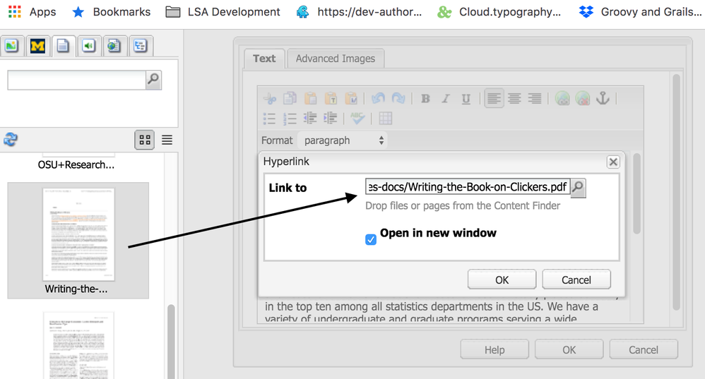

The issue discussed is a useful feature where users were able to build links from the RTE Link window by dragging and dropping assets such as PDF docs from the Classic UI Content Finder.
Adobe says that this is "not recommended" anymore. Seems it is not recommended because Touch UI lacks the feature.
