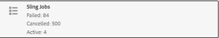

Our AEM application is running on 6.5.3. On system overview dashboard, under Sling Jobs, we can see large number of sling jobs either failed or cancelled. Please find below attached image. We need to analyze these jobs in details. Where we can find these sling jobs details? Is there any logs which are specific to these sling jobs?

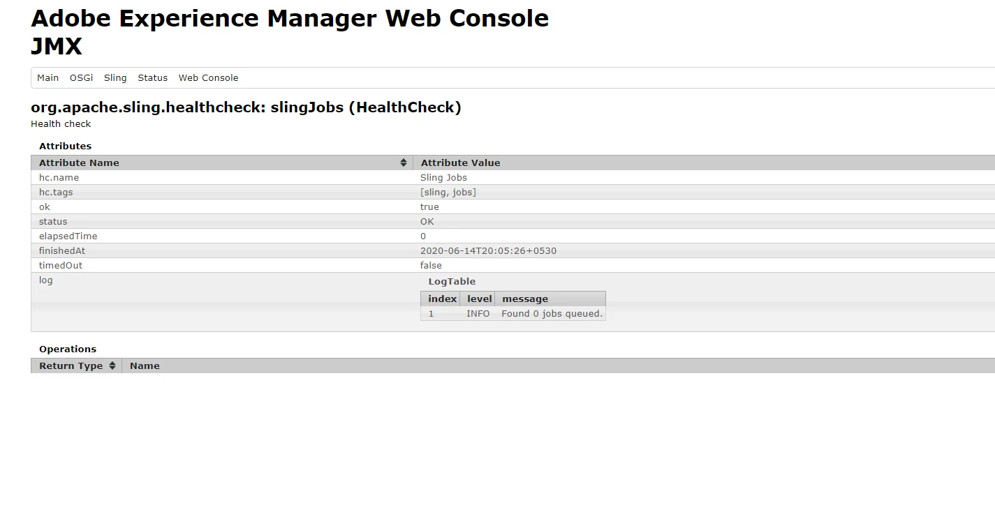

Hello Vikas,
You can get information about the sling jobs from the following MBEAN: "http://localhost:6530/system/console/jmx/org.apache.sling.healthcheck%3Aname%3DslingJobs%2Ctype%3DHealthCheck".
These jobs check the number of jobs queued in the JobManager, compares it to the maxNumQueueJobs threshold, and:
  • returns Critical if more than the maxNumQueueJobs are in the queue
  • returns Critical if there are long-running active jobs that are older than 1 hour
  • returns Critical if there are queued jobs, and the last finished job time is older than 1 hour
Only the maximum number of queued jobs parameter is configurable and it has the default value of 1000. See [0] for more details.

Hello Vikas,
[0]: https://github.com/AdobeDocs/experience-manager-65.en/blob/master/help/sites-administering/operations-dashboard.md
