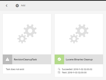

On the maintenance page the on the "Revision Clean up Task" it displays as Task Does not exist.This was enabled previsously.Also on system/console/jmx dont find the MaintenanceTaskRevisionCleanupTask
Please can you let us know how to enable this again.

It is as per the docs but I dont know how this task chnaged to "Task does not exist" and disappered in the JMX console.If this come in JMX console then the issue will be fixed.

I just encountered the same issue on an AEM 6.5 instance. There is another property that needs to be present: job.topics
job.topics="com/adobe/granite/maintenance/job/RevisionCleanupTask"
full.gc.days=["Mon"]
After adding this property, the Task became active again.
