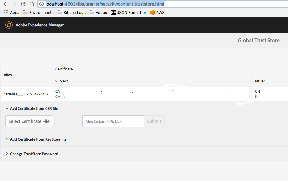

We are trying to integrate AEM Author(calling client) with a external REST service using SSL. On adding the public self signed certificate of the service onto AEM's trustStore we still see a SSLHandshake exception.
Used this section to add the self signed certificate into AEM TrustStore - http://localhost:4502/libs/granite/security/content/truststore.html
Please can you advice if I am missing anything?
No change in the error after adding the certificate to the trustStore.
javax.net.ssl.SSLHandshakeException: sun.security.validator.ValidatorException: PKIX path building failed: sun.security.provider.certpath.SunCertPathBuilderException: unable to find valid certification path to requested target
