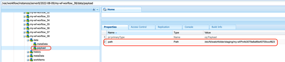

- I then triggered a workflow by dropping a file in the input folder of the watdched folder. If you have a look at the workflow instance in CRXDE, the 'payload' node has path to the payload:

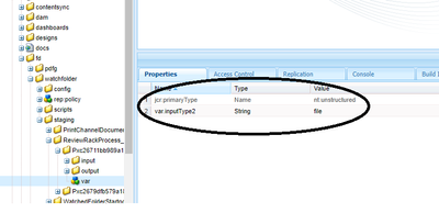

- If you navigate to that payload path, it takes you to the payload node where you'll find the custom watched folder properties, under node 'var':
This means that the custom properties are definitely part of the workflow payload, however I don't know if we can use this custom property in the workflow as an author, without custom code.

When I drop a file "data.xml" into the watched folder, the variable is not set.  And, the "var" node in CRXDE is empty.
I tried manually setting "workflow.var.inputType2" in CRXDE.  I created a workflow variable inputType2 and it is still undefined.  However, it has appeared in the "var" node of the instance just like @Nikhil_Verma shows in that example.
