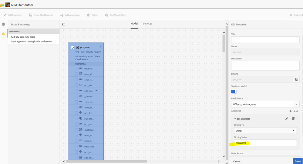

Dynamic CRM updated their fields and database and I went ahead deleted the ONE table I am working with on my Model and the Added it again along with the GET, PUT, POST, DELETE services. I am working only with one record and I hard code the table to just get me that one record with a parameter.
this is what I have on both environments
and my services
PROBLEM:
on both my local machine and VM server it retrieves the record while testing the model object and it also retrieve the array of records in the service GET. However when binding a value into a Form my machine can preview it fine but not the VM server. I get the error below:

Are the inputs from both the machine to service the same? Check the input datatype for the services as something seem to fail at that point only.
can you please explain a bit more, what do you mean by the input datatype? for what services? this is happening only on the server not on my local machine. and the data comes from Dynamic CRM thru a rest endpoint in azure for both.
yes Mayank something got wacked and I created a new data source
