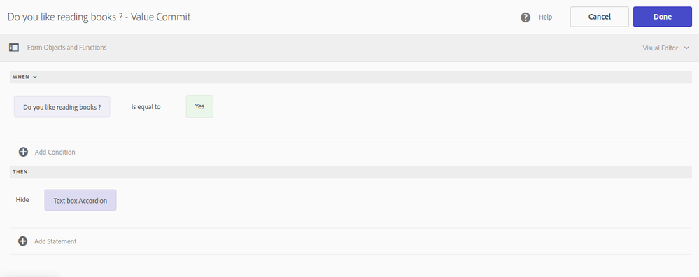

Hi Smac,
In the above screenshot, highlighted is the custom accordion component. Requirement is to whenever user selects option "Yes", the textfield above it hides. Below is the snapshot of the rule.
But it didn't worked.  I also tried applying the rule on the textbox not contained within the custom component but that also didn't worked.
