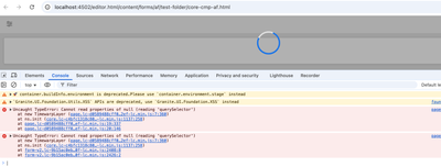

page.lc-d0589488cff0bf9ff3fa3c02f0a052ef-lc.min.js:7 Uncaught TypeError: Cannot read properties of null (reading 'querySelector')
at new TimewarpLayer (page.lc-d0589488cff0bf9ff3fa3c02f0a052ef-lc.min.js:7:360)
at ns.init (core.lc-c4bfc1318c80270bd84115fb22e49be8-lc.min.js:1137:258)
at page.lc-d0589488cff0bf9ff3fa3c02f0a052ef-lc.min.js:19:337
at page.lc-d0589488cff0bf9ff3fa3c02f0a052ef-lc.min.js:20:146
TimewarpLayer @ page.lc-d0589488cff0bf9ff3fa3c02f0a052ef-lc.min.js:7
ns.init @ core.lc-c4bfc1318c80270bd84115fb22e49be8-lc.min.js:1137
(anonymous) @ page.lc-d0589488cff0bf9ff3fa3c02f0a052ef-lc.min.js:19
(anonymous) @ page.lc-d0589488cff0bf9ff3fa3c02f0a052ef-lc.min.js:20Understand this error
at form-v2.lc-9b15ac0eba1f0e232cf3fc8835614b0f-lc.min.js:2408:8
at form-v2.lc-9b15ac0eba1f0e232cf3fc8835614b0f-lc.min.js:2426:2
After some investigation I found that one the component have clientlib folder and it have dependencies as: cq.authoring.editor.sites.page  and If I remove this dependency form is working as expected.
But I cant figure out how clientlib impacting to the adaptive form authoring even both are independent I am not integrating form in AEM page.
