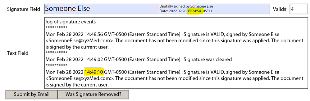

... And I just realize another issue: if I import data into an already signed form, the signature was not removed,... so there is now a data mismatch between the date of signature and and the recorded dates in the log. I thought importing data would reset the form first, including signatures. Any thoughts?

I guess you mean I should not import data into a signed form,... but Acrobat let me so I can. And my problem is the form I have developed is to track issues and interactions about it and we have experienced some ill-intentioned people changing the data content before passing it to another party. Although I cannot prevent that, I want to be able to detect it through a read-only log. I initially intended to check any mismatch between the last recorded signature validity status and the its status when initializing the form (like right after import). It does work except when the data is being imported into an already signed form. So I decided to check consistency not only with the validity status but also with the time-stamp. and it works.
