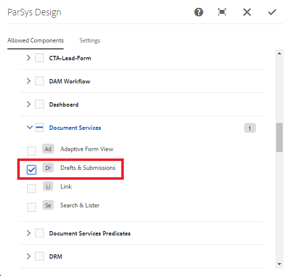

For the drafts and submission component to show up in the component browser, you need to follow below steps -
1) Select design mode and then select the drafts and submission component (Document Services component group) as shown in the below screenshot:
2) Now, go back to edit mode and you'll be able to the drafts and submission component in the component browser as shown in the below screenshot:

Thanks. It works after I go Classic UI, then follow step #1 Select design mode and then select the drafts and submission component (Document Services component group) .  The problems I had before is that I could not see Document Services component group in design mode in AEM v6.3 (OSGI).  I can see Document Services component group only after switch to Classic UI, then go to design mode.
