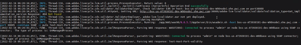

Hi Team,
We are trying to install the AEM JEE application  in WebSphere but we are facing an issue when we are trying to verify the server connection to the Application Server. We are getting the below issues and unable to proceed. Can someone please let me know the root cause of this issues and how we can fix that as we are trying different methods but unable to resolve the issue.

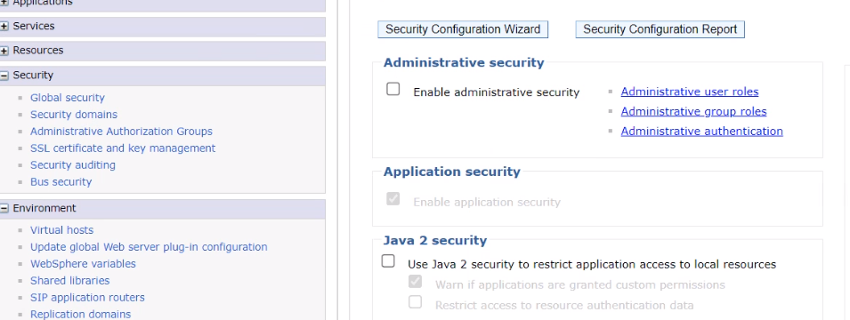

You may verify the Global Security from WAS Console > Security > Global Secuirty.

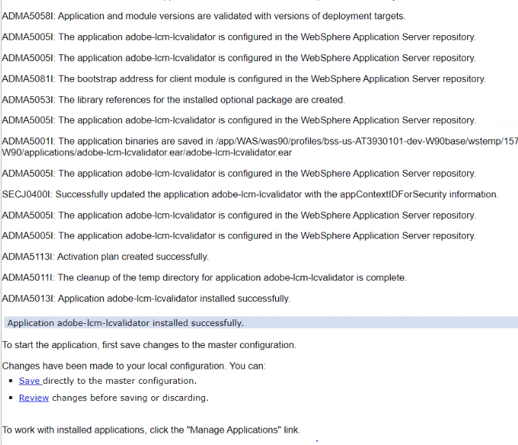

Also, seems like you have not deployed adobe-lcm-lcvalidator.ear which validates the application server configurarion.
Can you search of this ear in configurationManager folder and deploy the same on WAS?
Hi Mayank,
Please check the below screenshot for the WAS console and I have also deployed the EAR file but there is no different at allGlobal Security.PNG EAR.PNG
Have you saved the changes to master? After this, restart WAS server and retry the validate server step again, and share the errors generated in WAS' sysout.log and lcm.log?

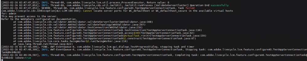

Hi Mayank,
We restarted the server, Please  see the below screenshot after the restart, So far the error is gone but we are still stuck with the original issue regarding the "wc_defaulthost and wc_defaukthost_secure" issues.
I can still see that lcm-lcvalidator.ear is not deployed.
Did you check in WAS console > Applications > WAS enterprise application if it is deployed?
Also, please check on below:
  1. Click Servers > Server Types > WebSphere Application Servers > server_name > Ports.
  2. Check the value for WC_defaulthost for the port number to use for non-secure, HTTP connections. Make sure this value is not the same as another port number in use by the application server.
  3. Click Environment > Virtual hosts > default_host > Host Aliases and make sure your port number is listed there. If not, click New, leave the "*" symbol for Host Name and enter your new port number in the Port field. Click OK.
  4. Click Apply, then click Save directly to the master configuration.
  5. Stop, and then restart the application server.

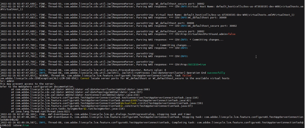

Hi Mayank,
I can see that now the port was not updated under the virtual host section and now i have updated it. Just a quick question, do we need to do the same for the wc_defaulhost_secure port also or only for the wc_defaulthost.
Pranay
Since your global security is off, you are not using SSL. So, as long as you are using HTTP, you do not need to configure wc_defaulhost_secure port. It should be configured only when you want to use HTTPS?
