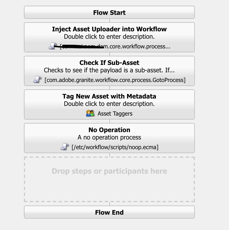

We have a case where one of our workflows seems to fail occasionally. The workflow is launched on Node Created with node type nt:file and path: /content/dam(/.*/)renditions/original. One of the tasks of the workflow is to notify users that an asset has been uploaded by sending notification to their inbox. This is the steps that seems to fail due to the fact that job has been done already and they indeed have notification for that asset already. The cause seems to be
Caused by: javax.jcr.ItemExistsException: node3_etc_workflow_instances_server0_2018-10-01_1_upload-asset_555 (Check full error below)
The step before the one described is a script that checks if the asset is not a sub-asset.

If we remove that step we don't see the occasional failures. The failures seem to be on different assets each time we upload the same group of assets. Is there a cause to think that the workflow can be executed more that once on node created or that this particular step that checks for sub-assets can cause the next step to be executed more than once?
Our model:
