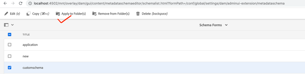

@Vani1012  : Check on two things :
a)same metadata schema with same set of fields etc exists on both env.
Check here :
http://<server:port>/mnt/overlay/dam/gui/content/metadataschemaeditor/schemalist.html?formPath=/conf...
b)same metadata schema has been applied on the folder where you are testing or on the root folder.

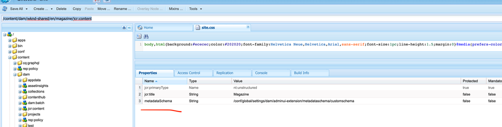

If you have access to crxde you can also check folder's properties where you are testing , should have metadata schema or any of its root folder. By default , all have default schema applied. Screenshot 2023-01-16 at 5.34.35 PM.png
