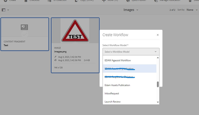

How to stop showing some workflows when multiple assets are selected?
We have a requirement where we need to stop showing some workflows in the create button that comes in the top in AEM Author instance when multiple assets are selected in our certain DAM path.
So, when we select Multiple assets those workflows should not be visible but when we select a single asset then it should be visible.
We run AEM 6.5 on premise.
Thanks.
There is no an OOTB way to do this, at least that I am aware of, so you will have to customize this, overlay the console, and add your logic to filter based on your requirements.
