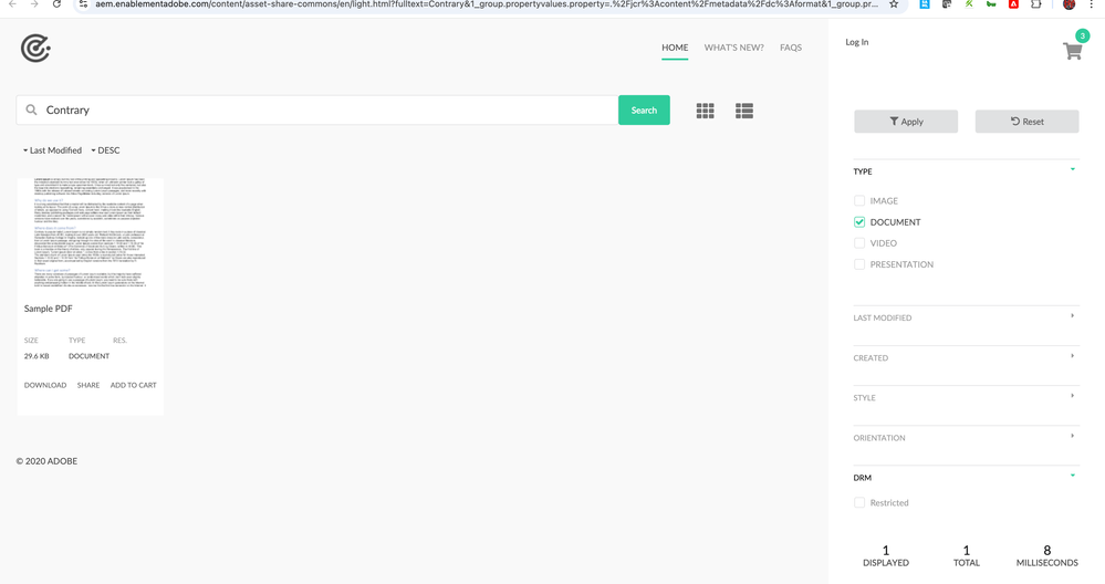

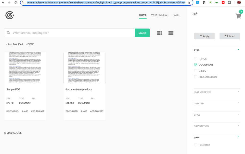

I searched for the term "contrary" in reference implementation in the search bar and only got a PDF. I was expecting both PDF and Word doc to show as search results as both had the same text and content. I am not sure if ASC supports search based on text/contents within the document. Can someone confirm if full-text content search within docs is supported in ASC?
https://aem.enablementadobe.com/content/asset-share-commons/en/light.html?fulltext=contrary&1_group.propertyvalues.property=.%2Fjcr%3Acontent%2Fmetadata%2Fdc%3Aformat&1_group.propertyvalues.operation=equals&1_group.propertyvalues.1_values=application%2Fvnd.openxmlformats-officedocument.wordprocessingml.document%2Capplication%2Fpdf%2Ctext%2Fplain&orderby=%40jcr%3Acontent%2Fjcr%3AlastModified&orderby.sort=desc&layout=card&p.offset=0&p.limit=1

digarg17Adobe EmployeeAuthor
September 18, 2024
On author it gives both results (doc and pdf) without doing any changes On new cloud prod instance. Issue is only on publisher with ASC.
