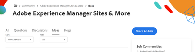

Hello @adilos-cantuerk
This seems like a very useful feature.
Can you possibly also submit this requirement under ideas section?
It would be good to have it OOTB
Aanchal Sikka
Adilos-Cantuerk
September 8, 2023
@aanchal-sikka thank you. I think so too!
Could you point me in the direction of the ideas section, i am not shure where to find it.
aanchal-sikka
aanchal-sikkaCommunity AdvisorAccepted solution
September 8, 2023
@adilos-cantuerk
- Visit Adobe Experience Manager
- CLick on Ideas Tab
- Click "Share an Idea"
- Fill in the details and we are good to go
Aanchal Sikka
