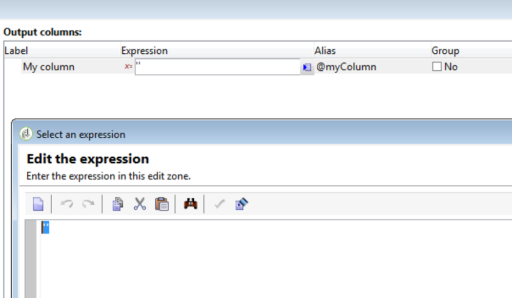

Hi SouraDeep,
it is transforming that to a NULL value at backend
INSERT INTO wkf77568_15_1 (sMyColumn,iId) SELECT  DISTINCT  NULL, R0.iRecipientId FROM NmsRecipient R0 WHERE (R0.iRecipientId = 7000) AND ((R0.iRecipientId > 0 OR R0.iRecipientId < 0))
So you will use the existing formula, NULL comparison will not hold true. The test condition will always return false and hence your existing lang will be selected.
You will have to modify your formula.
Iif(NoNull(@myColumn) != 'en' && NoNull(@myColumn) !='fr', 'cn', @myColumn)
Vipul

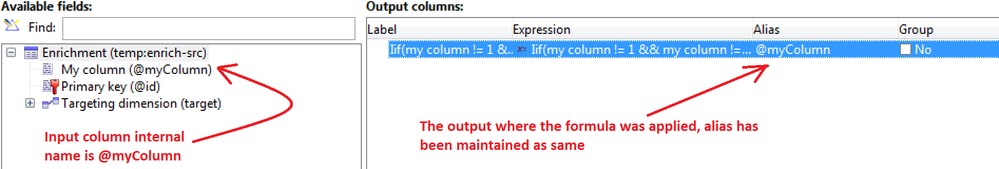

Hi Souradeep,
You can use this formula
Iif(@myColumn != 1 && @myColumn !=2, 3, 4)
So the above condition check if value of myColumn is not equal to 1 and 2 then the output will be 3 otherwise 4.
Now you also had a requirement that the output should be applied to the original field that is myColumn then you will have to apply the alias.
Hope this helps.
Vipul

Hi SouraDeep,
Vipul
