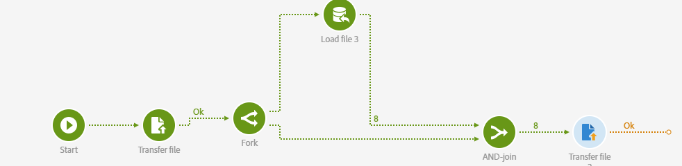

as said there is no such option available. The "Upload file" will take whatever is provided within the workflow transition.
Though as said:
* Use "download files" and specify "file present on Adobe Campaign server"
* This will fetch the file and store it in the temporary folder belonging to the current workflow instance
* In addition, it will be attached to the current transition
* Thus, adding a new "Upload file" afterwards will take that file and send it to SFTP/S3 destination
The only thing to take care of that the data in the transition is not getting overwritten.
i.e. if you have "Load File", it will have the line records in the transition.
Thus in my example above the Fork + AND-Join as by this the file pointer can be kept in the transitions
for that use case you would have to use the Transfer File activity.
Adobe Campaign Help | Transfer file
This will connect to the SFTP server, download the file locally to Campaign server.
You then can choose "Delete file after transfer" to have it removed from source directory
Then you can process it and use another Transfer File activity to put it back to the SFTP server.

The file would be taken from the transition.
So if you have a local file you would have to:

Hi Sakthi,
the "Load file" will change the targeting dimension so the file reference will be lost before the "Transfer file 3" activity.
What you have to do:
