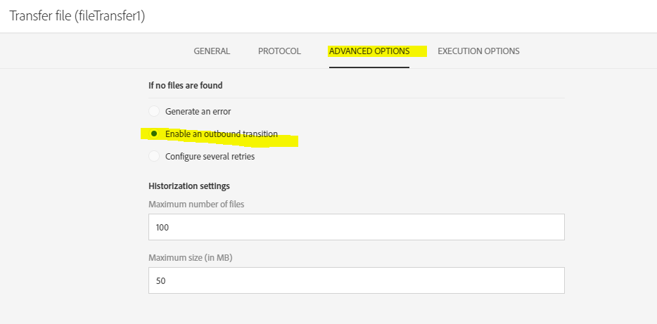

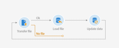

You can select the option to generate an outbound transition in case no file is present. And loop your update activity back to 'Transfer file' activity. It will loop and perform operation until there are files present in your SFTP location.
Thanks.
Thanks Jyoti!! It worked!!
