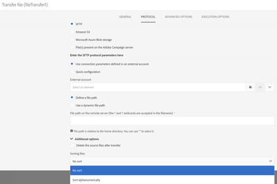

@derekw42533281 Did you try with the sort option in the file transfer activity? and within the load file activity select the "delete source file after transfer" option. This will delete the files once it's transferred to make sure storage space is recovered.

That didn't work. It only uploaded the last file and deleted the rest.

So in theory selecting the Alphanumerical sorting file should ensure files are loaded in the correct order.
