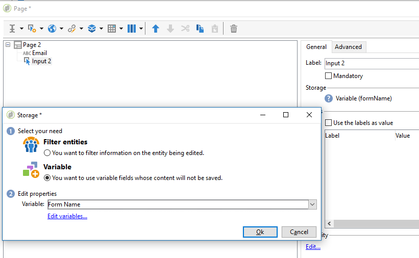

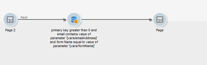

I am trying to build my first dynamic report.   I have a variable [formName] and my final reporting page will adjust dynamically based on the default value I pass in.
I have also been able to create an initial page with a text box allowing me to pass in a dynamic [formName] that is entered by the user.
What I really need is a way to have a drop down box populated with a list of options which are coming from a table because the options are changing over time as new forms are created with new "Form Names".
Can anyone tell me what the process is to have a Combo Box on a page that is pulling its values from a table or list and passing which passes that value to my variable [formName]?
The only option I see is to create a select box but then you have to manually enter each possible option.
The problem at this point is that the only option to get values into the combo box is to manually enter them.

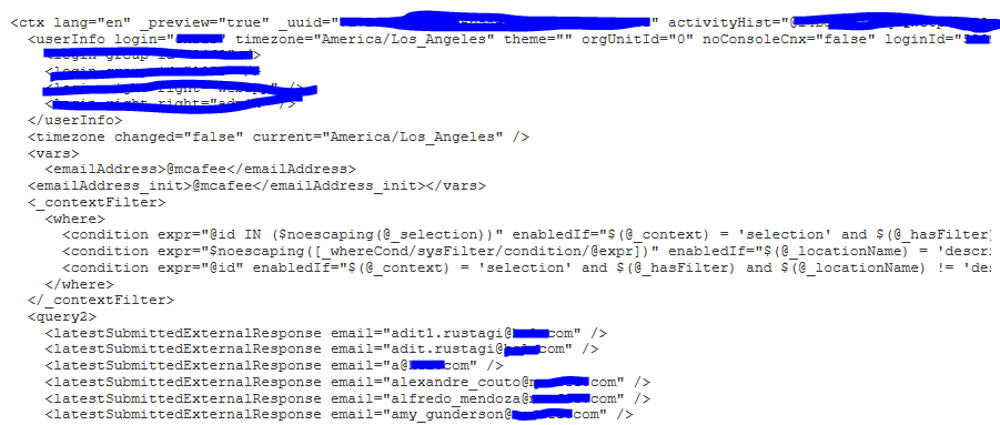

What I did was connect a query on the report canvas to my page with the drop down list:
Next I looked at the Preview in debug mode to get the XML output:
Here is what I have in my xpaths in the advanced setting for by drop down list:
Options XPath:  ctx/query2/latestSubmittedExternalResponse/
Labels XPath: @email
Values XPath: @email
I have tried all kinds of variances on the Options XPath, but must be missing something obvious.   Any adivce would get GREATLY appreciate.
I got it fixed.   The options XPath was supposed to be just starting with Query2 rather than ctx.    THANKS FOR THE HELP!
