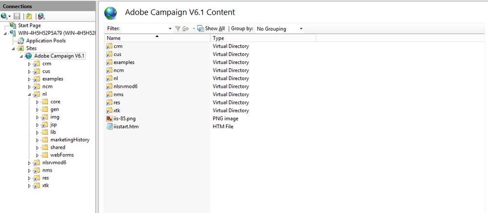

I can see the application folders in content view in IIS.
