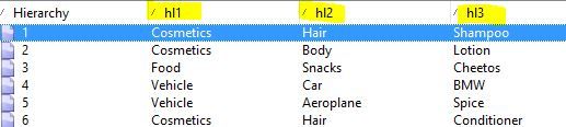

Thanks for replying.I was trying to create an input form containing multiple dropdown and values for this dropdown should come from different attributes of a single table .Here i need the values of hl1,hl2 and hl3 in 3 seperate dropdowns in the form.
If I understood correctly, you want the values of some column of schema in the Drop Down.
But, it is not possible to have the Values in the Drop Down.
The Drop Down in Adobe Campaign can only be created by the Enumeration, so only those values will be visible in the Drop Down which you are adding in the Enumeration.
