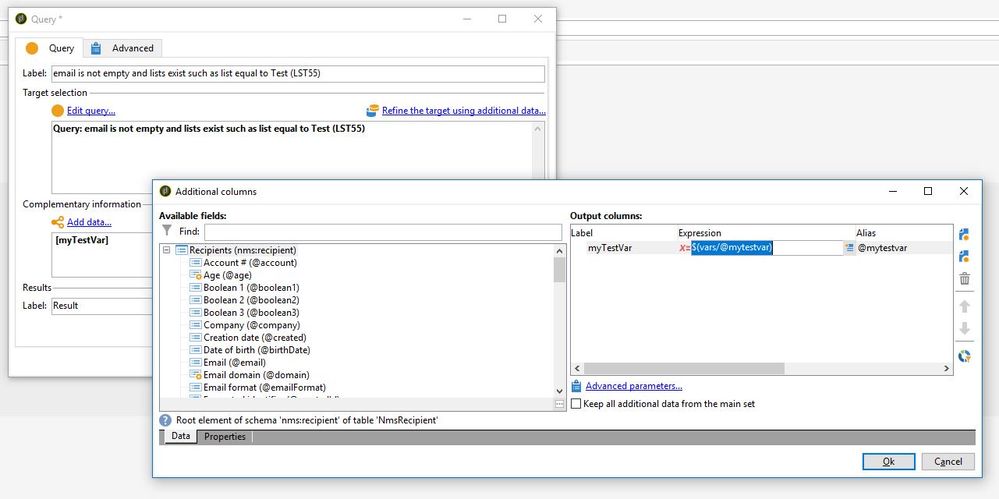

In the query activity, where I define the recipients, I add the variable above using 'complementary information' (also tried with enrichment activity, but end up with the same error).
Label: CmpDeliveries
Expression: $(vars/@cmpdeliveries)
Alias: @cmpdeliveries
When running the workflow I get an error:
ORA-210000 Oracle error: ORA-12899: value too large for column "CAMUSER"."WKF28138905_32_1"."SCMPDELIVERIES" (actual: 780, maximum: 255)...
The goal is to use the variable (targetData.cmpdeliveries) in a delivery (continuous delivery activity in the same workflow). It works if the variable has less than 255 characters. Any solution for string >255 characters?

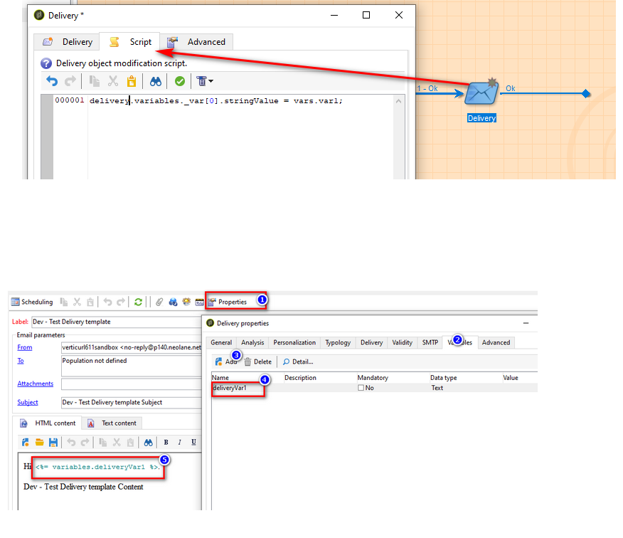

If you just want to use a lengthy variable inside a delivery, you can try using variables in delivery like following.

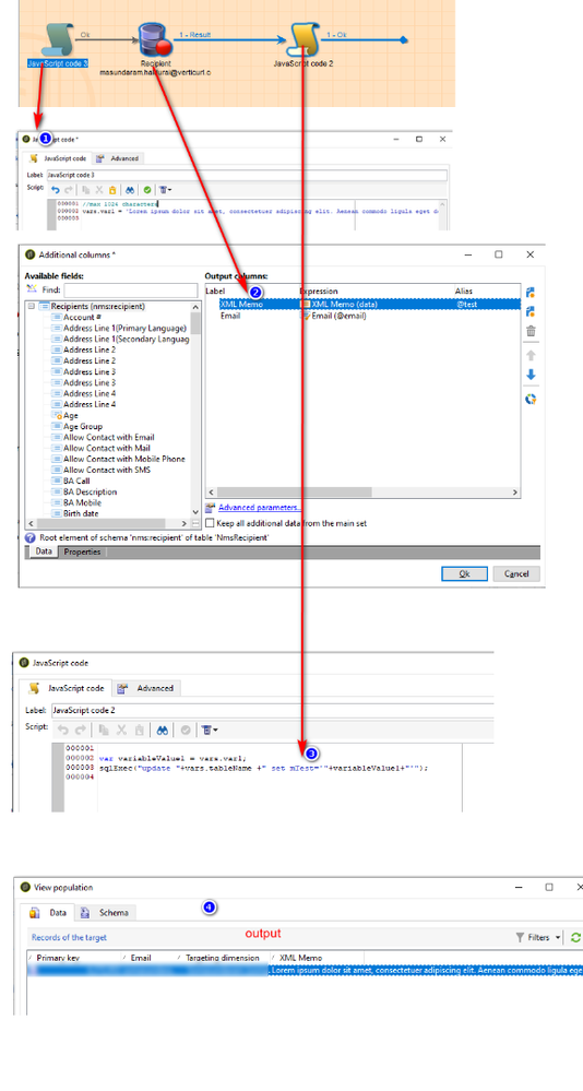

try adding something like this.

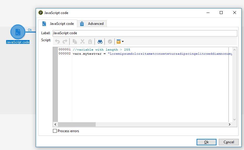

JS activity:
Query activity (Complementary information):
This activity fails if length(vars.mytestvar)>255; I don't want to store it in the DB.

Level 6
I think you can not query if it is stored as @data field and I think it is stored as XML.

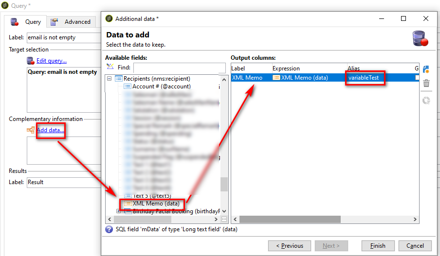

Hope the following helps you.
If you want to store different variable value to different user, you may need to use querydef in js and then update this 1024 characters field.
This looks promising. Output in "View population" looks ok. However, when I use "XML Memo" (@test) in the continuous delivery it is empty.
<%= targetData.test %>
Any idea?
Thank you! I marked this as the correct answer because it solved my issue.
But with this solution I can't use "Continuous Delivery" because the activity doesn't have a "Script" tab. I use now multiple "Delivery" activities instead and this works. If somebody knows a solution for "Continuous Delivery" activity feel free to post.
