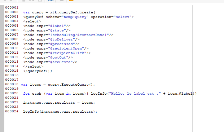

To give some context, I am trying to send in an alert all the last deliveries with their metrics. To do so I 1)run a query 2)use some JavaScript code to store the data in an instance 3)Run the loop in the alert.
The setup looks like this:

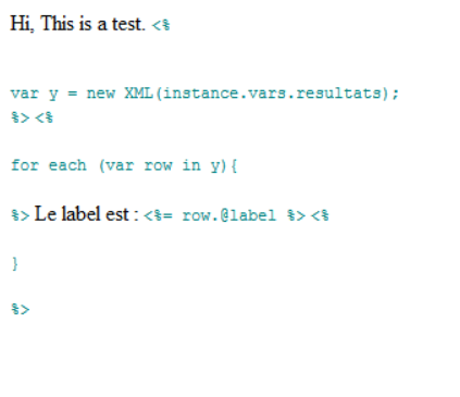

The JavaScript is the following:

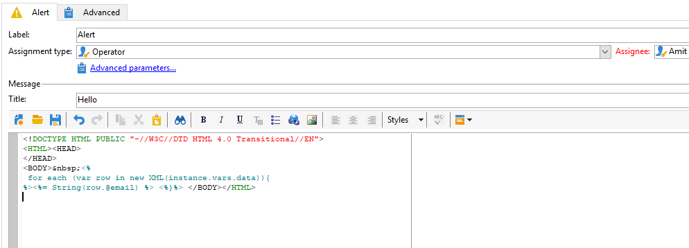

The alert code is the following:
I have not added all the Node expressions in the output as I just want to run a test at the moment. However, I get this error message:

Hi Marcel,
I am not using a delivery activity but an alert (as per the screenshots above) and it still does not seem to work.

Hi Kenji,
I have used a simple example to illustrate your case and it is working.
Step 1: use String when assigning xml value to a variable.
Step 2: use new XML to cast back a string to xml and use string to print the value of a variable.
if this doesn't work there will be something wrong with target mapping for your alert, try sending a static alert to debug that.
Amit
