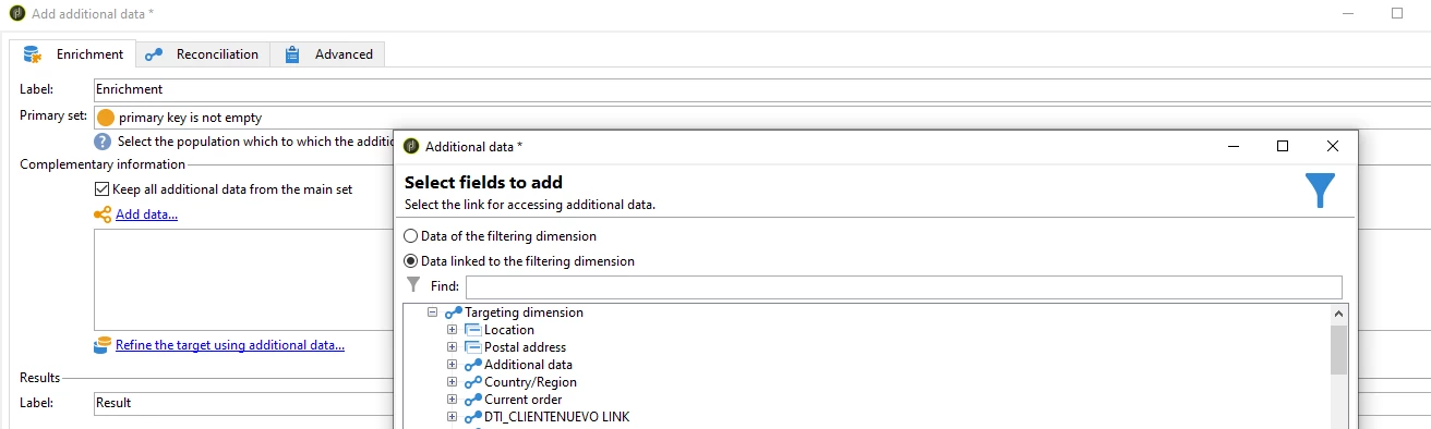

So, I've a case where we need the values from "channel_of_comunication_id" from schema "comunications_preference" when filtering "recipients" schema (the OOTB recipients).
I think, I have to ways to accomplish this:
1.- Link "comunications_preference" schema with Recipients.

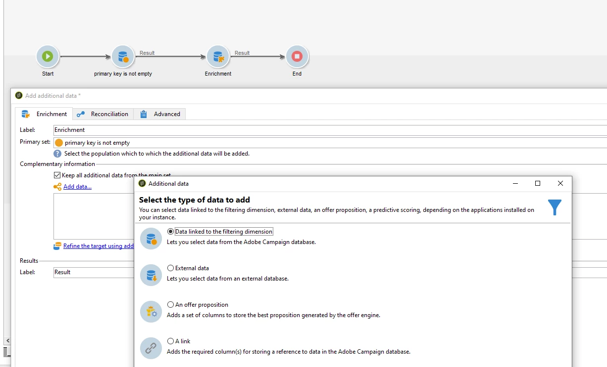

2.- Make an Enrichment in the workflow to get that column ("channel_of_comunication_id") from schema: "comunications_preference".  The field "recipients" and "comunications_preference" share is: "codinternocomputacional".
While trying to use Enrichment, I don't see the table "comunications_preference" as option to select:
Question:
1.- How to make the link with Recipients?
2.- Should I keed noDbIndex="true" for this case?

Hi @ogonzalesdiaz ,
The Column which is used as Joining Key in the Enrichment (The field "recipients" and "comunications_preference" share is: "codinternocomputacional") differs from the joining keys being used in the Link (<join xpath-dst="@id" xpath-src="@RECIPIENTID"/>).
Could you Please check by adding the right Joining keys, Also , as we know that the Recipient ID is the Unique Joining key in Recipients Schema, please make sure @RECIPIENTID in the other schema is also unique for your requirement to work.
<element integrity="normal" label="Recipient" name="recipient" noDbIndex="true"
revIntegrity="normal" revLabel="Recipient PreferenciasCom Link" revLink="comunications_preference"
target="nms:recipient" type="link">
</element>
Also reg the Index ,in the above mentioned Link if you are searching based on the column (@RECIPIENTID) in your Workflows while sending deliveries or in any of the activities, then you can remove  noDbIndex="true" in the Link.
Pravallika.
