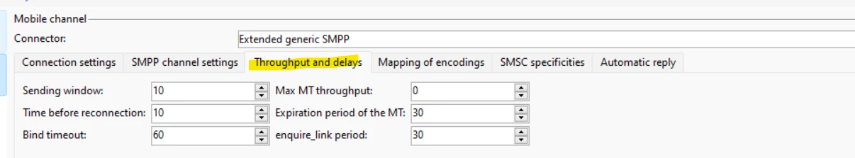

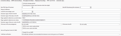

Can anyone please give suggestions after this? I'm sharing some config screenshots.

Best answer by costa_n11
HI @krishnakanth_patnaik_cc
I suppose you've reviewed the documentation on the topic
https://experienceleague.adobe.com/docs/campaign-classic/using/sending-messages/sending-messages-on-mobiles/sms-protocol.html?lang=en
Especially ensuring with the SMS provider that the connection they have on their side is of type Transmitter+receiver (or TX+RX) as indicated that ACC supports only this way.
You also must ensure ACC does not open too many connections that the SMS provider account can cope with, so do ask the SM provider the number of binds they have allocated to the account on their end.... if yous end too opens too many connections the SMS provider will block them, although they should see it in their logs.
Look carefully of the formula for the number of bindings that ACC will generate in the connection setting section https://experienceleague.adobe.com/docs/campaign-classic/using/sending-messages/sending-messages-on-mobiles/sms-protocol.html?lang=en#connection-settings:~:text=still%20be%20respected.-,Connection%20settings,-SMSC%20implementation%20name...
Number of MTAs are the number of application servers / containers the marketing instance has while number of MTA child processes is the maxthread condif on the servercong. xml file.....
You need to align all of the settings of the external account with the SMS provider and I would say your external account is not configured aligned with what the SMS provider account provides on their end..
Hope this helps,
Dens
