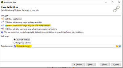

Use Enrichment activity to add a link to recipient :
after that use this link to filter your work table so as to keep only the records with empty or null recipientId.

Thank you @Amine_Abedour for helping me out!
