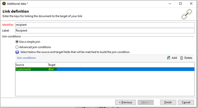

 I have uploaded a file for recipient schema, now I am uploading a new file for recipient schema with some of the existing values, I want to see only new inserted data by using activity in my workflow. I think I have to put join between existing and new data on customerID, But don't know how to do that.
Can anyone help me on this, an immediate response will be highly appreciated.

Hello @Mrityunjay,
Use Enrichment activity to add a link to recipient :
after that use this link to filter your work table so as to keep only the records with empty or null recipientId.
Br,
Amine

Hello @Mrityunjay,
Br,
Amine
