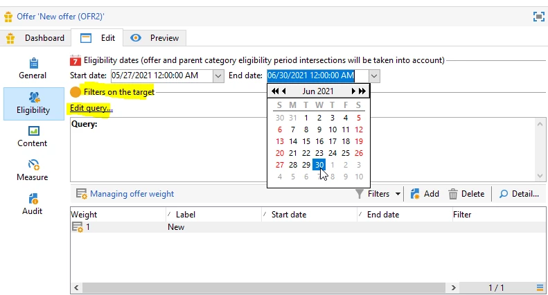

Campaign Interaction Offer | Adobe Campaign
PFA: Screenshot.  There you can add both conditions.
2. You also asked for the " If the customer redeemed the offer and met both conditions then ACC needs to process the rules and update the status to offer fulfillment status." in your first point.
There first you need to check what is your feedback process. Once you send or create a offer to a customer by any channel (email, CRM, mobile) then it create a propositions. Then you need to update the propositions after this offer is redeemed using a feedback flows. With this feedback flow offer status would be updated. This feedback depends upon channel to channel and your setup.
For e.g.  Adobe campaign receive a feedback file form CRM that this offer is used, then status of this offer is updated in adobe campaign proposition table.
3. For your second point,  End date in offer configuration is refer to "till when this offer will be used by offer engine".
For redemption is important to check, how redemption is done and by which channel.
For the redemption, if you are using adobe campaign in real time check, then you can add this buffer during the offer validation check.
If you are exporting to other channel and they are doing validation then you can add 7 days buffer during export. It can be manged by channel where redemption is done.
