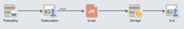

This is my current workflow for the web form.
Is this possible to use the JavaScript to pass the language field = "EN" to the recipient table using the workflow below, and what is the JavaScript code?

Thanks David for your reply. I am currently using default form creation from Adobe Campaign under online \web application, please see the workflow below. I added the JS script activity and try to pass the language field = "EN" to the recipient table, it didn't work.
Could you please take a look at the code below and let me know if there is any workaround?
