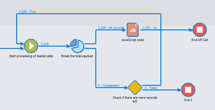

Best answer by iambhosale
Hi @milan_vucetic
Generally, we have observed that the JS activity in Adobe Campaign Classic only processed approx 9000 interactions and throws error after that. To handle this concern rather than doing any code-level changes we have used Test activity to check the count and the split the count into the batches of 9000.

iambhosale
iambhosaleAccepted solution
April 27, 2020
Hi @milan_vucetic
