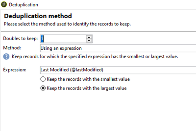

Hi @SriBhargav_94 ,
As you have 2 transition, In any one of the targeting activity add a segment code or create a dummy attribute
Join the 2 transition with Union activity
In Union activity, Select 'All shared Columns' in Reconciliation
In deduplication activity, Select temporary schema > Select 'ID' in identification of duplicates > Deduplication method: select method: Using an expression >
Expression: Last Modified > Keep the records with Largest value
