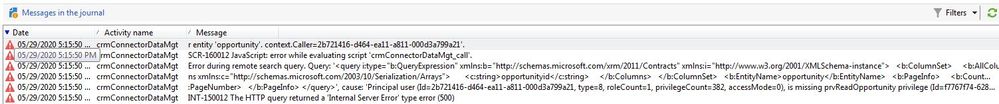

I am receiving a workflow error when trying to import data from dynamics 365 into Adobe Campaign using the CRM connector. The CRM connector is configured.
This error is appearing on a few tables that I am trying to pull individually to test the data load. The below error occurred after pulling 2 fields from a table.

Hi @radhikas2660960 ,
seems that your user does not have rights to read the table.
Please, check as well check if your Access Mode = Administrative because needs to be Read-Write.

Thanks Milan! So the user from the Adobe Campaign end does not have rights to read the table? This means they need to change the setting in Dynamics 365 to provide us with access to read the table?
Also, where can I check the access mode?
error missing Opportunity privilege usually means that user does not have enough privileges.
Report issue and do followup with them.
Regards, Milan
