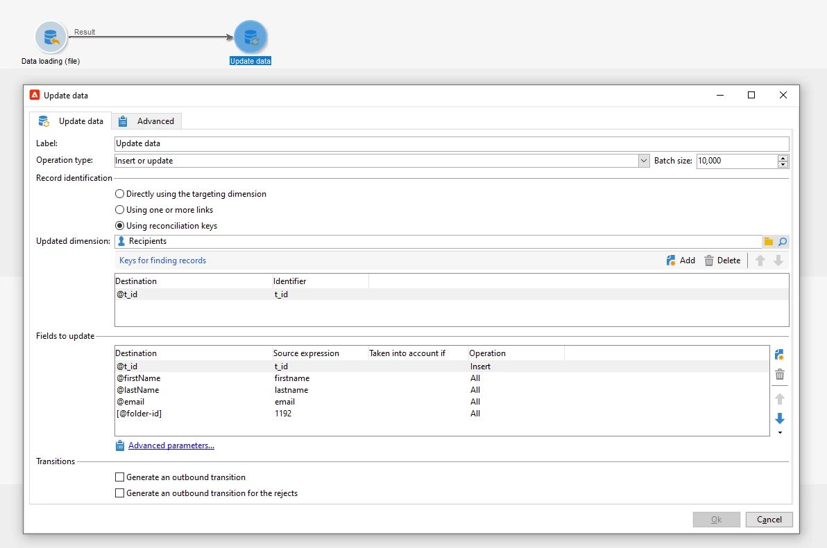

As Darren proposes, it is important to know how you perform the join with the targeted data. Update activity propose several option. the first one is to use implicite links. This requires your incoming data is from an existing schema that is linked to the schema you want to update. This option is valid when query nmsRecipient then update nmsRecipient for example. Now, whether your data is coming from another source like an external file for example, then you have to explicitly reconcile the data with the targeted schema.
As a best practice :
  • Field(s) used for reconciliation should can be inserted but not updated (cf. "operation" attribute)
  • Field(s) used for reconciliation are usually the one(s) that define(s) the unique/primary key for the table
  • When inserting a new row, make sure you provide all mandatory data to avoid blocking the insertion because you forgot to set default value for some mandatory fields. This should not happen with OOTB attributes of the nmsRecipient table as we have set default values but this could happen with custom attributes when Recipient table is extended

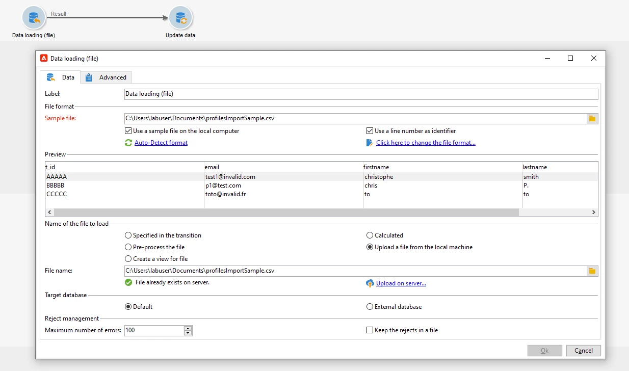

Here is a test I did :
#1 - Extended recipient with a t_id key :

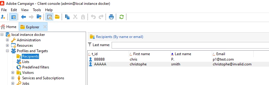

#2 - Created 2 recipients :

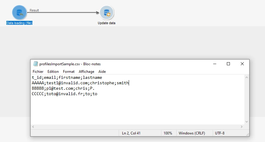

#3 - Import a sample CSV file

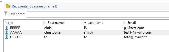

We expect 1 profile updated, 1 inserted, 1 unchanged
#4 - Import workflow implementation
We use t_id a the reconciliation key

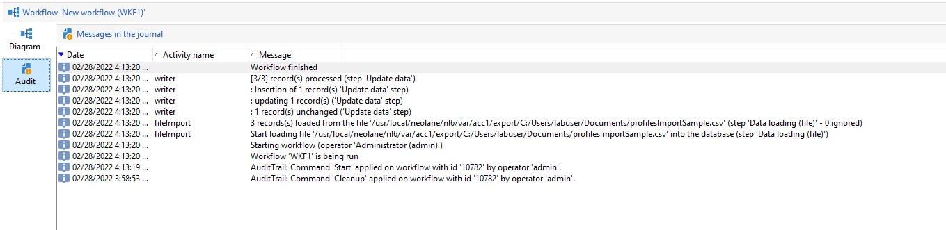

#5 - Log is as expected with 1 profile updated, 1 inserted, 1 unchanged
here we go
