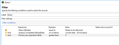

Hello, @connorSlack24, you can create a technical workflow that queries every minute the delivery schema with these parameters:
With it, you query all the deliveries from campaigns that are waiting for delivery for more than 30 minutes. After that query you can use a javascript code to fill a variable with the names of the deliveries:

It did, and it didnt, however I think the "didn't" component is due to our complex schemas we have and LIKELY something I missed.
Following changes made to the above worked for me.
1. use "(" instead of "{" for the create function
2. Query activity should be on nms:delivery.
3. Enrich the transition with the 'label' attribute otherwise the temp table only gets 'id'.
