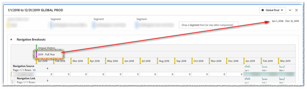

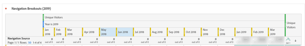

Try this on your own and tell me it isn't frustrating.  I'm trying to use the Month field between to Freemform Tables.  I want 2018 under a segment in one and 2019 in another.  However, Workspace doesn't work this way.  For instance, if you create a Panel that spans 2018 thru 2019, then create your two segments, one for 2018 and one for 2019, you will get a Charlie Foxtrot as a result.  Instead of the months of Jan - Dec of 2018 underneath one and their respective months for 2019 in the other, it gives me 15 months for both, starting with January 2018.  CRAZINESS!
In order to get what I want, I have to create two separate panels, set the year for each and then go after the data.  The problem with this is that I cannot compare and contrast the data next to each other in graphs or otherwise.  SUPER FRUSTRATING.

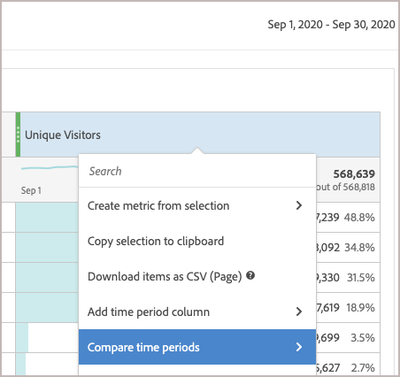

Have you tried using a custom date range to specify your months? You might also be able to right-click on the metric and try the "compare time periods" option.
This obviously puts everything in a single table/panel, but it will let you get a side-by-side view of any two date ranges you need to compare. Is this close to what you're after?

That was actually the first approach I used, and unfortunately, doing the comparison doesn't give me all 12 months for both years to pull.  I was trying to get everything so I could easily pull it into a workbook for consolidation.  One would also think swapping out a custom date range in a duplicated freeform table would swap out the months, but that was not my experience even after I refreshed the project.  As you can see in the screenshot below, I have a date range for just 2019, but the months appear to be driven by the top-most date range in the upper right-hand corner.  Highly counter-intuitive to what I would expect, as I would consider the Month as a breakdown of the time period.  I even tried to use YEAR, and that didn't work, either.  This is unfortunately an Adobe problem, I think.

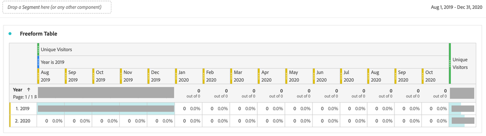

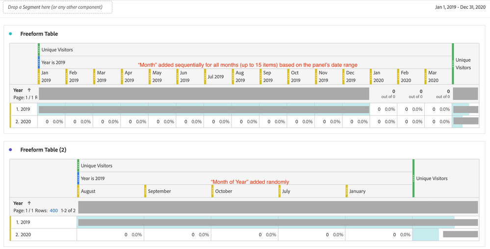

@jeff_bloomer , I think I've been able to replicate your tables.
As indicated in my screenshot's annotations, the "Month" is based on the panel's date range. For example, if I changed my date range to start from 1 Aug 2019, then I'd get this:
But it's worth noting that the data is still correct. Notice that only the 2019 months have non-zero numbers (which I've grayed out).
I think @pier-olivierd92's suggestion is the best option for you. But as you've noted, and as I've indicated in my first screenshot's annotation, "Month of Year" is treated as a string, and its values are added (seemingly) randomly. So if I were you, I'd do the following:
  1. Click the "Month of Year" in the left rail to show all of the month names.
  2. Drag the missing months into the table as columns.
  3. Rearrange the months to be in chronological order.
It's also worth noting that you can right-click in a metric and choose "Compare time periods" or "Add time period column" that can maybe ease your work, as @Brian_Johnson_ suggested.
