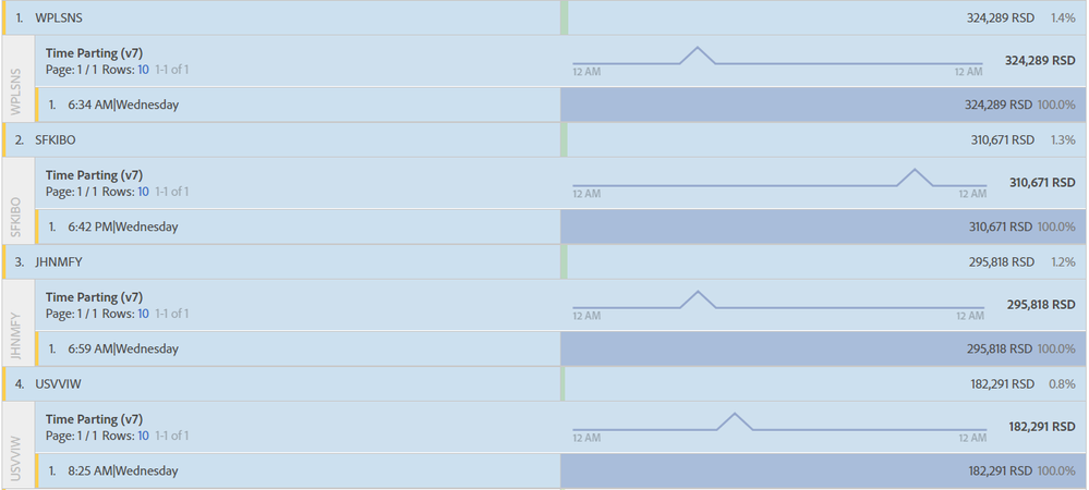

I have a work space with multiple rows (200+) of values for an eVar. I want to breakdown all 200 rows by another eVar and then I want to breakdown each of those breakdown rows by a 3rd eVar so that each of the orignal 200+ eVars has 2 breakdown rows. I can get the first breakdown done for all rows by selecting all the rows of the first eVar. But when I then select all the rows with their breakdown and try to add the 3rd breakdown all I get is the last row selected to have the original eVar with its breakdown and the breakdown with its breakdown. All the other rows stay static with the single original breakdown. Screen shots attachedFirstbreakdownAllRows.png2ndbreakdownAllRows.png
What you're trying to do isn't yet available in workspace. I'd recommend doing this in Ad Hoc, then once we've introduced table builder into workspace, you can make the transition.
