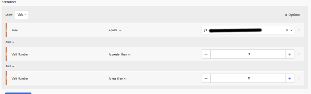

What if you made 2 segments...
Here is a screen grab of a way to delimit a visit range against a page... You can create different segments for different ranges of minimum levels.Screen Shot 2018-07-04 at 15.03.26.png
Hi Pablo,
I was under the impression that a segment is just a collection of visitor IDs, Visits or Hits that follow a specific definition. It is not a collection of other dimension items, e.g. products. (though that would be a great feature)
According to  the Visit Number help page, it's the n'th visit of a specific visitor.
So, your segment would include all hits in visits that included a view of page "xyz" and are visits number 4, 5, 6, 7, 8, 9, 10 of that specific visitor. When I tried it in my segment builder, the dialog showed a kinda small number of hits/visits in that segment but that may be different when you have a site that is regularly used by the same visitors (twice a month or so, like a banking site).
kind regards,
Thomas
Hi segments can be almost anything you desire...
Can be a page, with a a purchase event and for a specific product for example...
Like any filtering the more detailed and complex the segment is the smaller the results tend to be.
Also when building a segment Check under compatibility as some segment elements are not compatible with other parts of Adobe Analytics.
