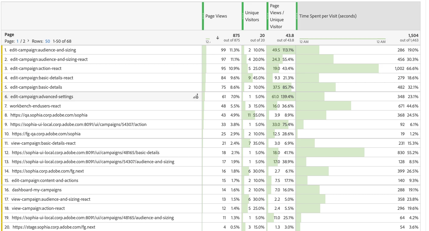

We are trying to ingest pageNames to adobe analytics but in some cases instead of pageName, pageUrl is getting ingested, due to this inconsistency data is not looking correctly in adobe analytics dashboard.
Is there any configuration required at code level so that I can fix this type of issue.
Please find the attachment below.

As you can see in above screenshots, pageName and pageUrl is present in dashboard
eg:
pageName: edit-campaign:basic-details-react
pageURL: https://sophia-ui-local.corp.adobe.com:8091/ui/campaigns/48165/basic-details
pageName is already assigned to every route we have in our application, above is just one example from them.

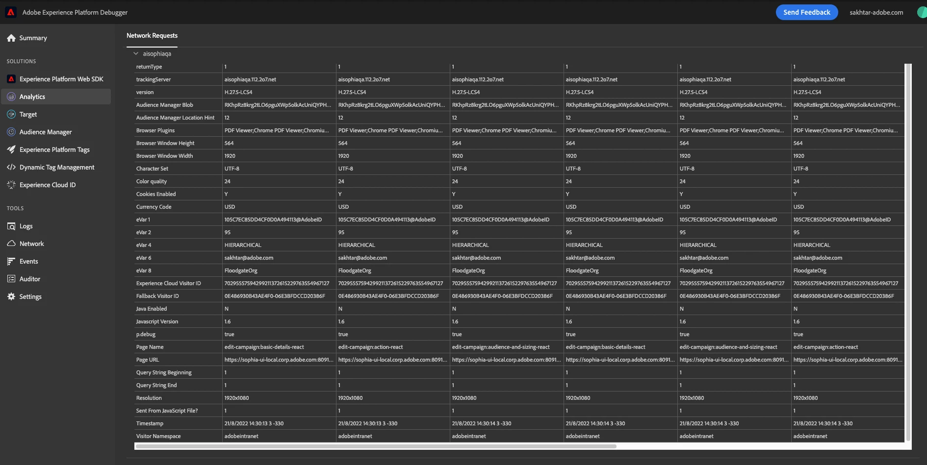

Adobe Experience Platform Debugger Screenshot
In above screenshot, as you can see 2 entries are present, first one is when application is loading and second one when application is fully loaded, in both the cases pageURL is same , but in first one pageName is not present or not defined.
Pls Note: First entry is not coming from our code.
can we handle these type of scenarios.
