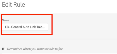

create a rule, and name it whatever you like but be precise and clear: for example

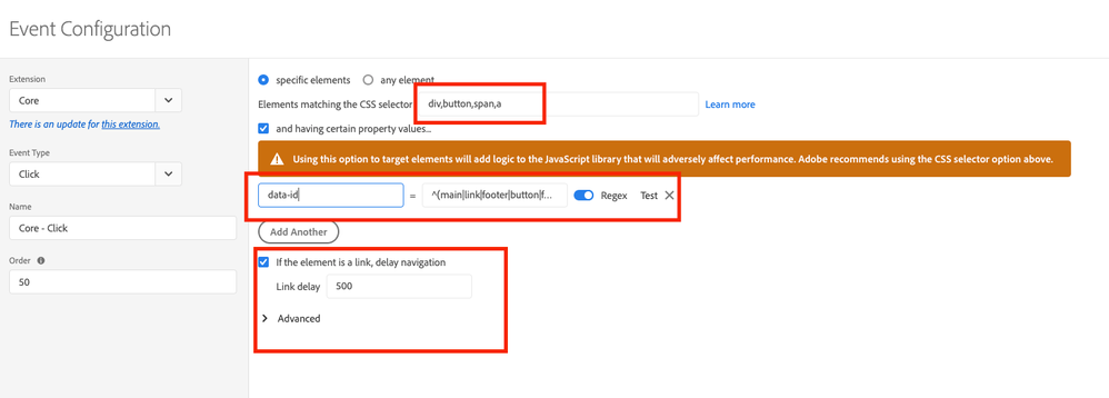

My rule is a global rule, it listens to all clicks on the site
Then you need to set up a Core Click event type
On the image above, you can specify the elements where you need your rule to listen too, for example, if you nested you custom HTML attributes on div, button, span, etc
then you can drill down to even specifying the custom attribute type and use a regular expression to set the types your rule should expect on the data-id attribute
I use the delay function because of the nature of my website.

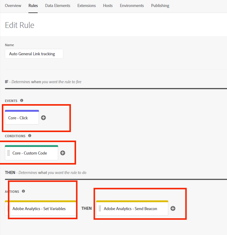

Then you can set up a custom code condition to create a virtual Data Element variable that holds your link name values when the beacon fires please see screenshots below
Once you are done this should be able to solve your problem, for additional info on how to use the virtual custom link Data element please see below, set this up in your s,tl() beacon
