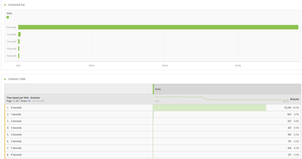

When I try to click "Try in Analysis Workspace" it actually gives me Visits by Seconds, not Time Prior to Event by seconds.Try it in Analysis Workspace.PNG

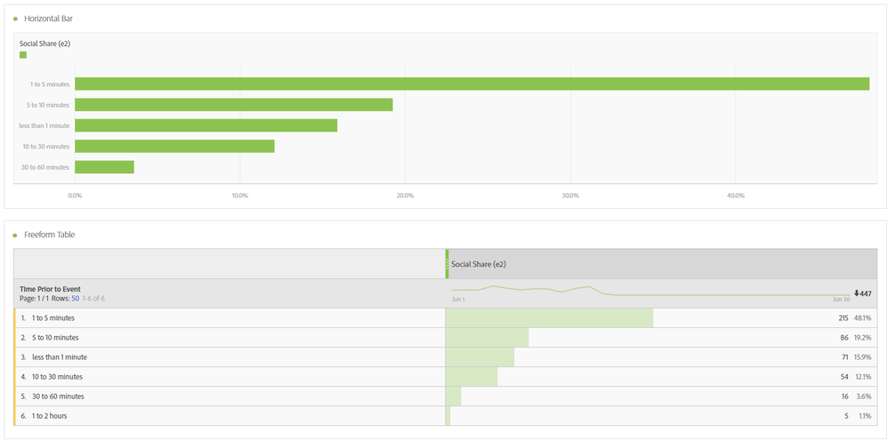

To test further, I tried to setup a Time Prior to Event report when I was already in an Analysis Workspace project, still comes out bucketed.
