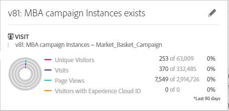

I have a created a segment for particular campaign as shown below:

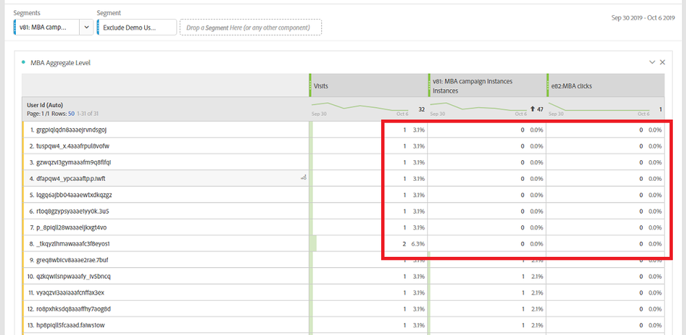

I am using the above segment to filter out the campaign visits from overall visits. v81 fires only when user see the banner(campaign). Along with v81, I am firing event83 as a counter.  As in the below screen shot, row#5 has 2 visits, v81 = 0, e83= 0. How is this possible? when v81 = 0 (means v81 not fired for that particular visits) how come Segment named v81: MBA campaign is allowing that visits in the report. I think row#5 should not be present in the below table. Please help me here.

your segment is looking for VISITS where the eVar81 matches SOMEWHERE within the visit. that means the user in row 5 had the login/userID set AFTER the eVar81 has been set. sounds possible?
the easiest fix would be to change the segment to HIT container where "eVar81 instances = 1" (only get hits where you have eVar81 on the hit)

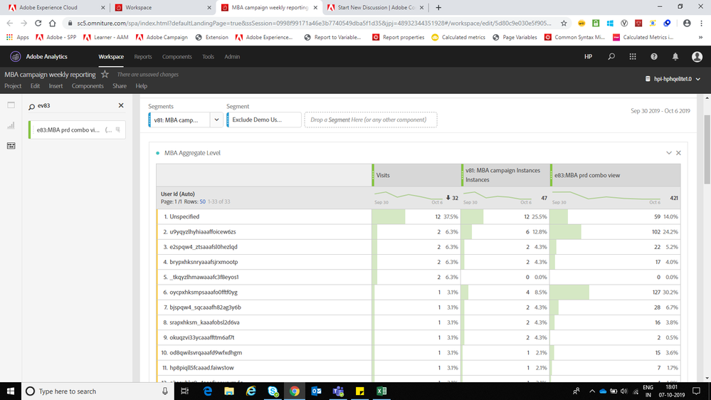

I changed the segment to HIT, but still issue exist. PFB the screen shot.
