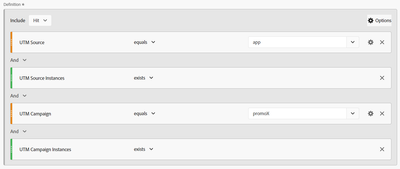

HIT
eVar1 equals app
AND
eVar1 Instance exists
AND
eVar2 equals promoX
AND
eVar2 Instance exists

HIT
eVar1 equals app
AND
AND
eVar2 equals promoX
AND
