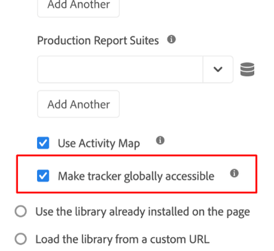

I am configuring Analytics via Adobe launch and s is not defined. The auditor in the debugger indicates everything is OK, however, the code I'm deploying is not reporting activity and s does not exist. What piece am I missing? I believe I should be able to should be able to type s.t in the console in my browser to verify everything is running. Also - where can I confirm I have the correct tracking server info? Is this what was called "Data Center" in older versions?
Hi @bobc76334831 , could you please check the highlighted box below and give a try again:
I hope this helps!
I hope this helps!
