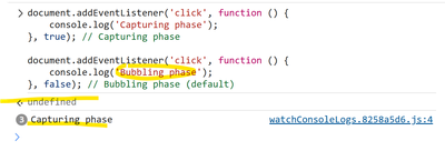

Additionally, I’ve discovered an easy way to test whether this issue is related to event bubbling (see below).
By tweaking the options parameter in the listener, we can quickly determine whether the event type bubbles or not.
  • If true, the event listener is triggered during the capturing phase of event propagation.
  • If false, the event listener is triggered during the bubbling phase (default).
Event propagation in JavaScript consists of three phases:
  1. Capturing Phase: The event travels from the root element of the DOM down to the target element.
  2. Target Phase: The event reaches the target element itself.
  3. Bubbling Phase: The event bubbles back up from the target element to the root element.
By default, most event listeners in JavaScript respond during the bubbling phase, but you can also configure them to respond during the capturing phase.
document.addEventListener('click', function () {
    console.log('Capturing phase');
}, true); // Capturing phase
    console.log('Bubbling phase');
}, false); // Bubbling phase (default)
Upon multiple interactions with the shadow DOM element I get the following log.
