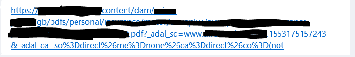

I can see the pdf tracking count but another thing I noticed in analytics report which add some query string at the end of the link showing multiple records.  For reference attaching below screenshot. If you see below after .pdf extension few parameters getting added.
So just wanted to know how the query string added here in report ?
Do I need to set s.linkLeaveQueryString  here ? Default value is False but still I am able to see OR any other configuration var

Weird. If you didn't set s.linkLeaveQueryString to 'true' it should not capture the query string parameters, however can you set the parameter to 'false' and see the result?
Sounds illogical, but testing can give some sort of understanding rather than assuming.

It also could be a custom variable - if it's a prop or eVar, you'll want to strip the query string yourself.

@gokula If you using DTM?
Go to Adobe Analytics Tool > Click on Gear icon next to an installed Adobe Analytics tool from the Overview tab > Within Adobe Analytics tool  > Go to Link Tracking > Enable "Track Download Links" > Enable "Track Outbound Links" > Disable "Keep URL Parameters"
Let me know if that works.
