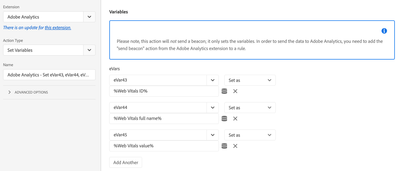

Here are screenshots of an example rule that sets eVar43, eVar44 and eVar45 using the Web Vitals data:
23 Replies
Thanks @yuhuisg

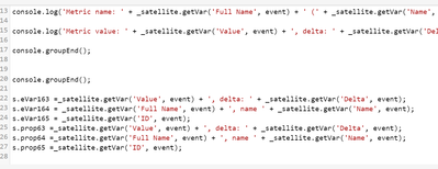

Can you please also share what logic have you used in the custom code action.
(Action --> log web vitals event)
Here you go! I basically created data elements from what was available in my extension, and then log them out when a Web Vitals event occurs.
console.group(event.$rule.name);
console.log(event);
console.group('Metric ID: ' + _satellite.getVar('Web Vitals ID', event));
console.log('Metric name: ' + _satellite.getVar('Web Vitals full name', event) + ' (' + _satellite.getVar('Web Vitals name', event) + ')');
console.log('Metric value: ' + _satellite.getVar('Web Vitals value', event) + ', delta: ' + _satellite.getVar('Web Vitals delta', event));
console.groupEnd();
console.groupEnd();

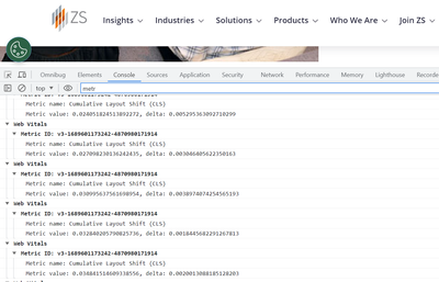

Hi Yuhuisg,
I have added a Custom code. CLS and LCP events are getting accurately captured. But CLS and LCP are getting triggered multiple times as shown in the below SS. Due to this page view calls are getting triggered multiple times.
