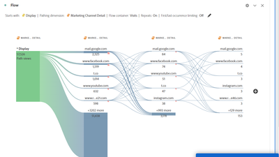

It might be helpful to use a flow diagram on marketing channel detail, including repeat instances.
Here's an example from our sandbox. Start with Display channel, then pathing by detail. (Scope is visit, with Repeats turned on). Could be helpful to add segment to the panel for the pages you're having issues with as well.
