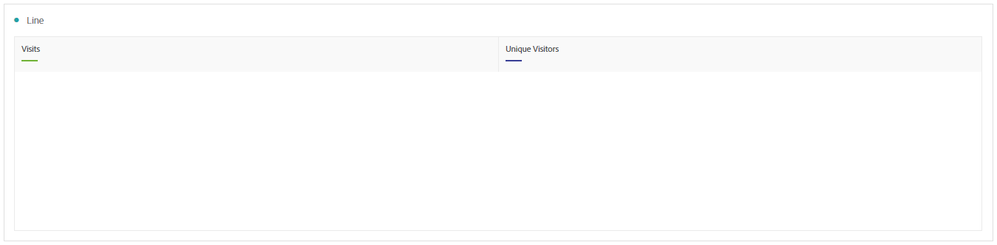

Since the recent update to line visualisations in Adobe workspace, these no longer appear to be working.
This through any method of generating (dragging in from components, right click> generate line & using insert >line.
When this is done, an empty visualisation appears as below, showing the correct headers, without generating the actual visualisation;
This is on every metric, segmented & unsegmented, and we could do with this issue resolving asap.

Best answer by KeriannSu
Looks like this is caused by the Tagtician Chrome extension. When workspace updates, it sometimes conflicts. The Tagtician folks are usually on it pretty quickly. I usually just keep my Tagtician disabled by default.
KeriannSuAccepted solution
May 15, 2019
December 2, 2019
@@Chris.LeylandI had the same issue for a month. I updated to latest Chrome version, and cleared my cache and cookies and start working after all. I hope it does the trick with you
